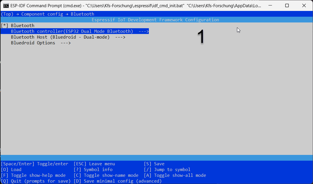

The only additional thing to do is to enable the legacy bluetooth in the config settings. I'll see if I can dig out the info for you on how to do this.
Hopefully the config is already correct but let us know if not,

The best and easiest way is Flowcode App Developer to test and use Bluetooth with ESP32.
With a notebook, Bluetooth is usually already available.
With a desktop, you can plug in a dongle.
Flowcode App Developer offers many practical functions for connecting and send/receive date with Bluetooth.
Here is an info about how to config for Bluetooth SPP from ESP32 and Flowcode.
It only looks complicated, but it is simple
I hope it's help a litle...
How to do it....
ESP32_Bluetooth_Flowcode.pdf
(474.01 KiB) Downloaded 320 times
Config Progam:
