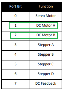

Your flowchart compiles for me OK, but the connections to the motor are wrong.
You will also need to select Full bridge if you want the motor to also go in reverse.
With the connections, the motor is connected to pins 1 and 2: You can determine the correct connections from the Eblocks2 datasheet.

I have updated files as you suggested and noted that the mechatronics pack does not have a red x. I have modified the motor to pins Port B1 and Port B2 the programme now compiles but the hardware i.e the motor does not respond. I have sent a photo of the set up in which the BL0127 board ic connected to port b and a copy of your modified file
