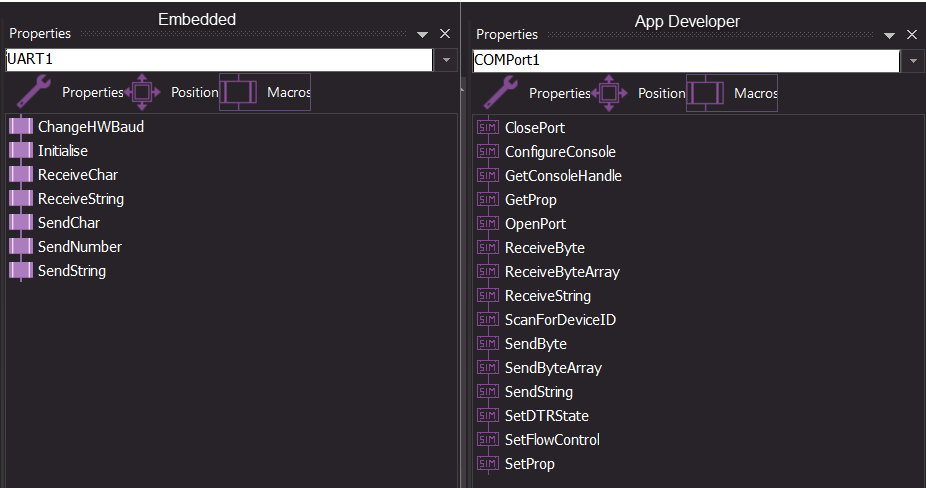

I saw how comfortable the comport from the App Developer is. Sending receiving byte array looks great.
Is it possible to have the same in the Embedded for the uart. So that it match together.

Yes good suggestion I have now upgraded the UART component for you with a few more hopefully useful functions.
It can now send and receive: strings, arrays, ASCII decimal, ASCII hexadecimal, ASCII float, 8-Bit Binary, 16-Bit Binary, 32-Bit Binary and 32-Bit Floating point Binary.
I'll see if I can add the additional functions to the COM port component as well as they should hopefully prove quite useful.
I'll hopefully get them both on the update system for you later tonight.

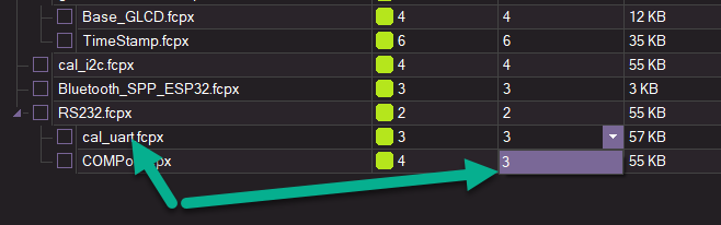

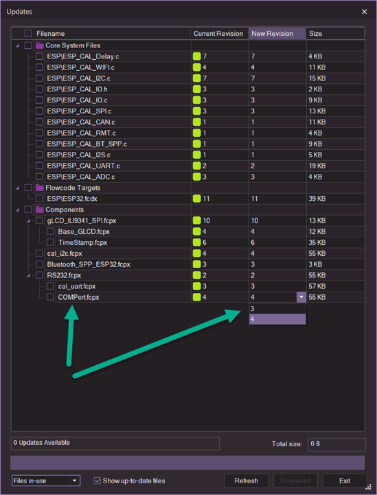

There is a small problem now with the uart in all my program (also in the ESP32). I cant compile anymore.
So I have looked to undo the last update, but there I saw for the cal_uart is not a lower version number available.
For the comport there is a lower number available but comport version is working anyway.

Thanks Stefan,
Should be fixed now.

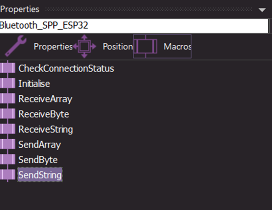

Unfortunately with the fantastic ESP32, bluetooth isn't over the UART. It is made with a component Blue_SPP_ESP. If an upgrade were also possible there.
