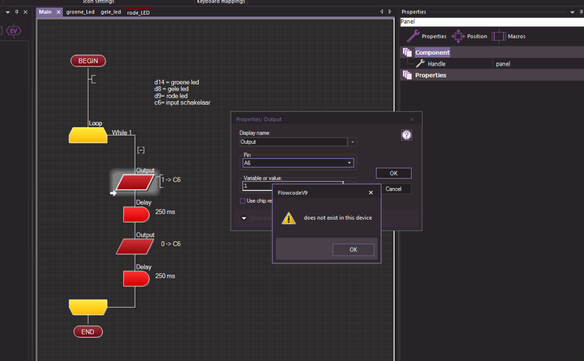

hello
The probleme still exist , tried updating no update's found
kind regards Ruben

Pin ADC6 and ADC7 are analogue input pins only and cannot be used as digital pins. You should be able to use the pins with the ADC components such as the potentiometers and sliders.
