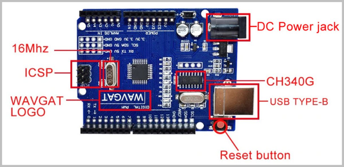

I have now installed the AVR tools and I am trying to program the UNO(first time in my life working with an ATMEGA)
as you suggested Ben I am using Xloader to program the hex file that is working however from FC I cannot program as FC is looking it seems for AVR programmer(AVRdude not sure) ,where do I download the programmer SW that FC is looking for ,I looked for Avrdude but find a lot of things I will not trust(russian sites :D )

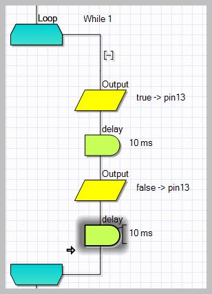

Then Creating a simple chart that toggle led at pin13 on the UNO it is working fine but the timing is out by factor 3 (set 10mSec delay actually 30mSec9,Please help me to setup the UNO correctly Ben ,as the I2C debugging I want to do at the end of knowing the UNO is running correctly wili not work now.
I have the impression the mcu is running on a internal 4Mhz Clock ,can this be I do not know this micro
(It is a chinease clone Wavgat they are actually a good company for these clone stuff :? the board has a 16mHz Xtal on boards)

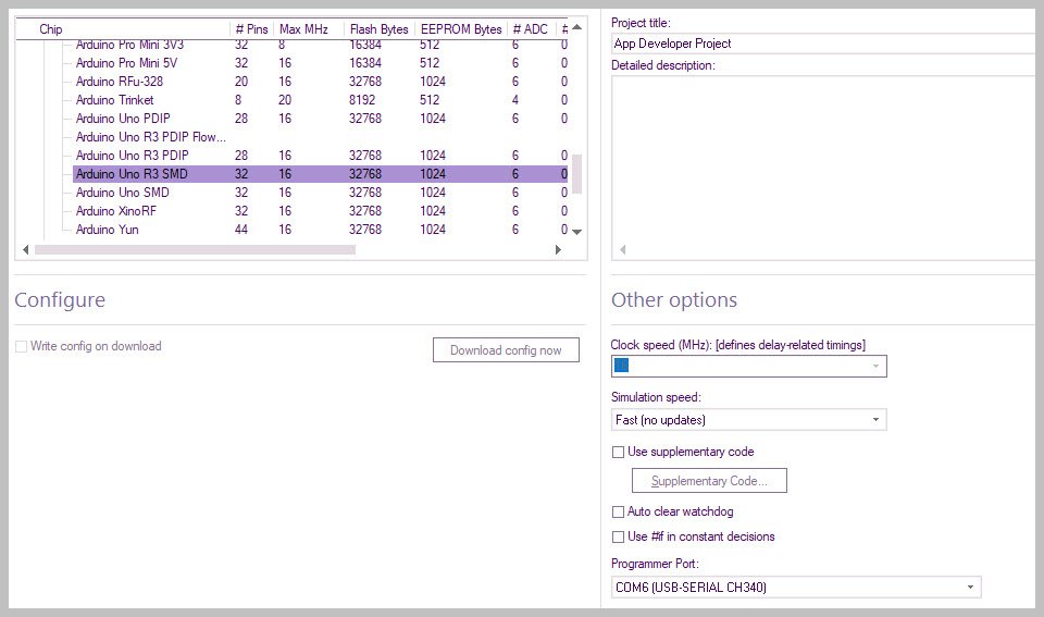

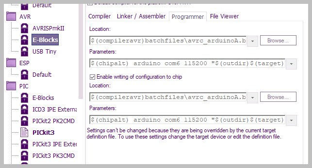

Flowcode comes with Avrdude, you should just need to set the COM port in the project options to allow program to chip to work. Note it may look selected but make sure you go in and actually click on the setting as there is a known bug where it's not actually selected.
Strange about the timings. There is an internal oscillator but it's set to 8MHz not 4Mhz so that's very odd. The chip should come programmed with the correct config settings to allow it to run at 16MHz so it's strange.
Are you using the ATMEGA328P or the Arduino Uno R3 target device in Flowcode?

Yes you are right it look as if avrdude is selected and the reason Iwas thinking I miss the tool :D I will try to set it up ,
I am using the UNO R3 as here ,What should I use Ben ?

Seems I can not change or make the programmer settings active Ben,I try to brows or click on the tabs with no effect :oops:

I noticed the Following the Board Bootloader is set to a baud rate of 57600 and flowcode do 115200 this is the first issue why Flowcode do not connect I think.
