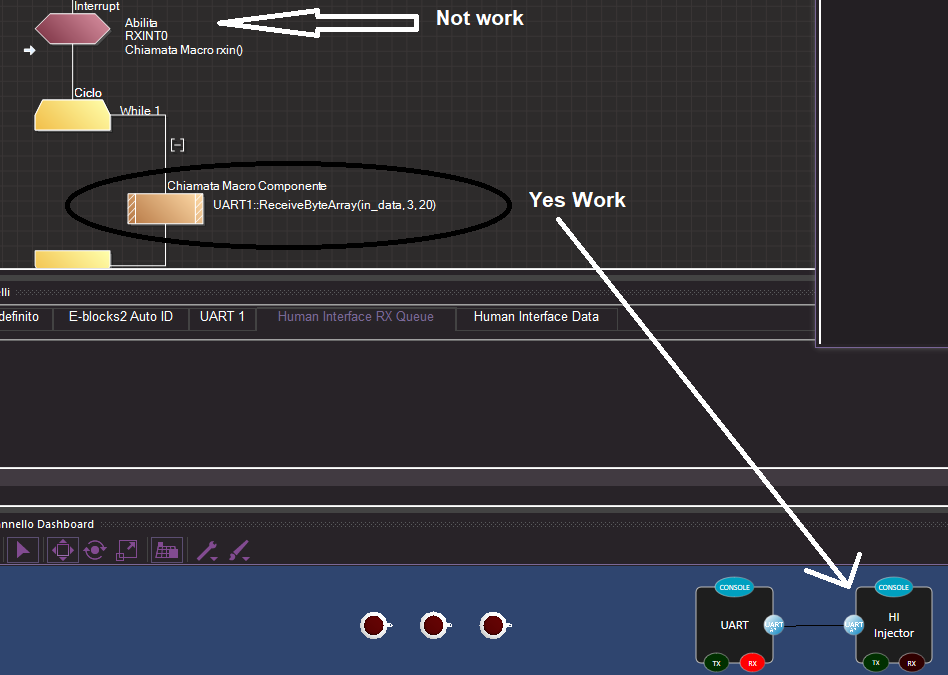

Hi I made a simple uart program and an interrupt on rx, then I entered humaninjector and readbyte only etc. it works but the interrupt doesn't fire, am I doing something wrong?
Thank you

The RX interrupt does not simulate but it should work on your hardware.
Also, the Circular buffer is great when it comes to reliable communications.
So, I have attached a project for you to try.
It uses a circular buffer component and allows you to use HI injector without interfering with your hardware.
As it's not a bug but known not to simulate, I'm moving this topic from bugs.
