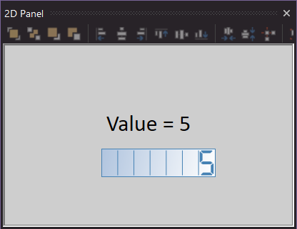

Hi!
I remember Martin medelec35 show for a while ago in an examble a great tool where it is possible to show a vaiable/number on 2D panel during simulation.
Can´t find the location, please advice. :D

Hi Jorgen.
This is the easiest way I can think of.
Let me know if this is OK or if you need further help.

Exactly Martin, good tool. Thank you very much :D

For future reference, the component you require called Text, can be found within the Component Libraries > Creation > Primitives (2d) > Text [2D]

After I saw your examble, I found it, perfect.

Hi Martin, Hi Jorgen
Sometimes I use this component: NumericIndicator
can be found within the Component Libraries > Creation > Primitives (2d) > NumericIndicator
Variable on 2D Panel_NumericIndicator.fcfx
(10.82 KiB) Downloaded 260 times

Hello Stefan!
Thank you, another good option :D
