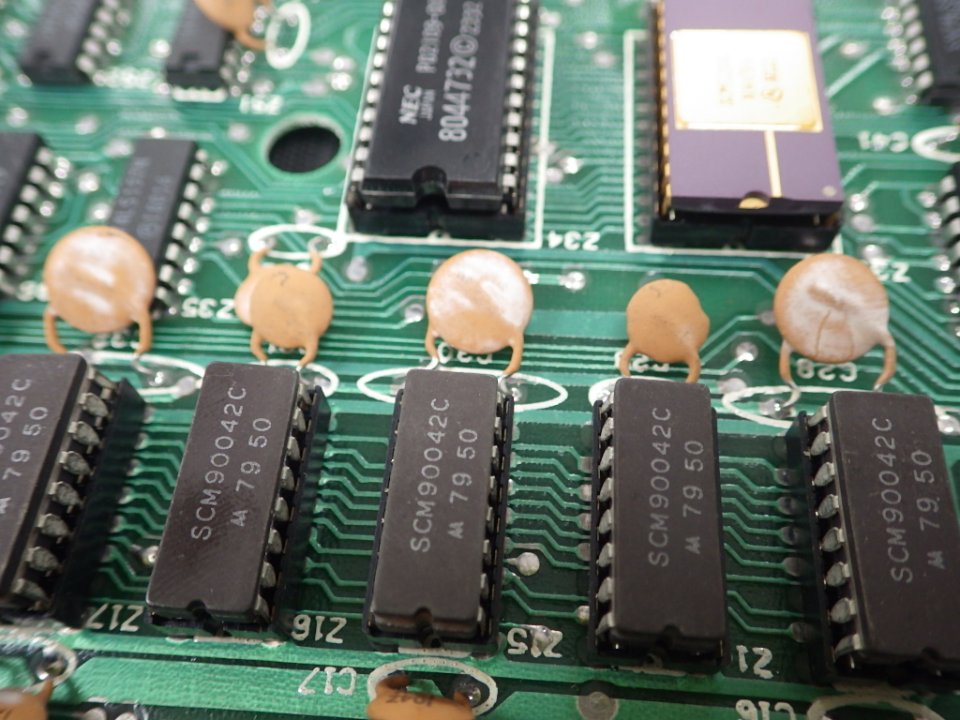

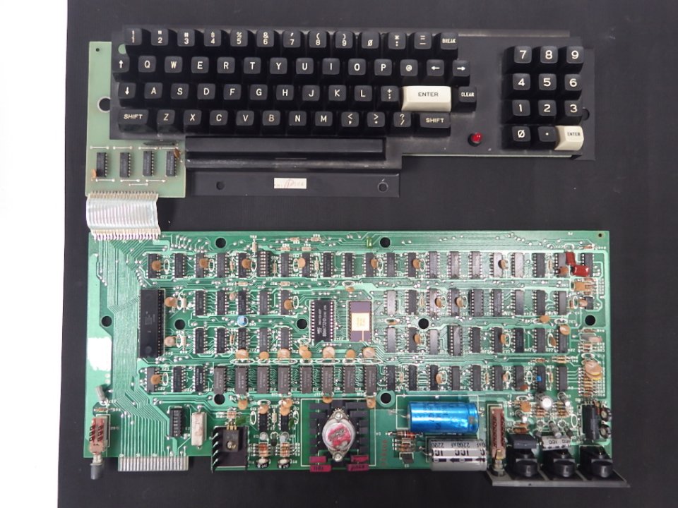

Some pictures
Keyboard and PCB

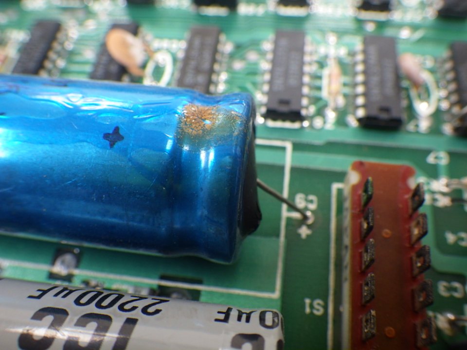

10,000uF Electrolyte a bit worse for wear
Not sure what the white stuff is on most of the Discs are but they seem to test OK
Although I have a copy of the Technical Manual, I searched for SCM90042C to see what came up. Nothing.......... best was a link to a site offering RFQ for obsolete components. Guess back in the day RAM would have been a bigger deal :)

Thanks for the photos - an interesting bit of kit.
Plenty could be done in 16k - it's high res graphics that have driven much of the need for speed and memory. Display data need lots of memory moved around at high speed - character mapped or low res (monochrome too) displays need a lot less power to work with...
Check out Mr Carlson's Lab on youtube for info on capacitor 'degradation ` and testing. Mostly old radio refurbs but he is very good..

Very interesting site that Lab. It looks like with the discs it's just ageing of their shell's, so no big deal as all I've tested seem fine. Couldn't get my hands on a reasonably priced 10,000uF so 2 x 4,7000 in parallel should work OK, at least for my testing.
