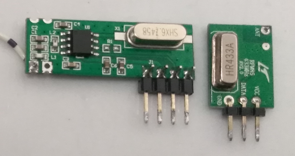

I assume you are using one of the super-cheap 433MHz modules available everywhere. These are cheap for a reason and can be a bit of trouble to get working.
You say that your Tx/Rx code works when the UARTS are hardwired together, but not in RF, which would point to the modules. This post may be of help (old forum)
https://www.flowcode.co.uk/mmforums/vie ... hz#p105540

I use RF modules from HOPERF Electronic, they are not expensive, the receiver module uses an RFM83C integrated circuit. Thanks for the article you suggested.
- RFM85 & RFM83.png (629.6 KiB) Viewed 2149 times
