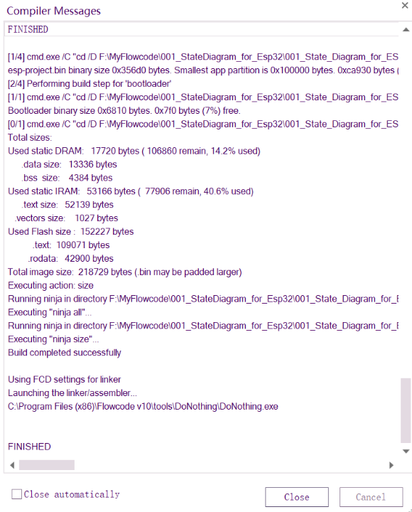

Been thanked: 5 times
Re: Could you please help me figure out why the state diagram program for ESP32 always fails to compile? Thank you!
Post by niedian »
It's already done.
Posts: 2454
Has thanked: 792 times
Been thanked: 851 times
That's great.
Thanks for letting us know.
