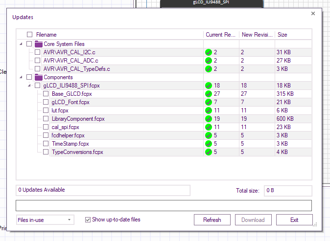

Can you post your fcfx and .c files please.
Have you run Library updates to make sure you are sung the latest components?
