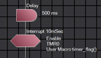

The interrupt on the ESP32 working nice if you just set a variable.
If I want to sample my IMU with an always constant time it would be practical to do this with the timer.
But I cannot insert commands in the macro called by the timer without the program in ESP32 crashing later.
Is there a way to change this?

You could maybe set a flag in the timer code and then react to that flag in the main loop of your program. It's always best to minimise the actual code within an interrupt routine.

Yes that what I do at the moment. I use a flag
With one big disadvantage.
When I write the buffer to the sd-card I miss the samples and the speed and position is not correct in the calculation later in the Appdeveloper.

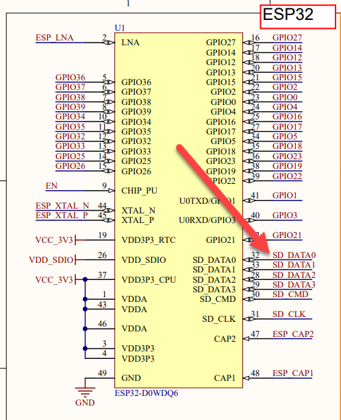

A quick method to write on card is to make one big block at a time and write to the sd card all 512byte at once
file_write_block.fcm
(6.29 KiB) Downloaded 1108 times
Very good with the 4Bit SD card.
I will look for a suitable hardware where the SD card are wired to the SD_Data pin and not to the GPIO pin.
And check it out!
