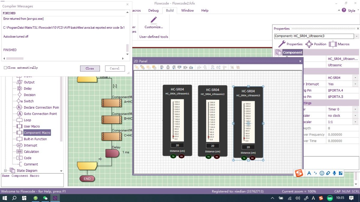

Multiple HC-SR04 sensor compilation errors.help me.Thank you.
Multiple HC-SR04 sensor compilation errors.jpg (141.04 KiB) Viewed 1370 times

I beleive I have fixed this for you now if you get the latest timer component via the Help -> Library updates.
