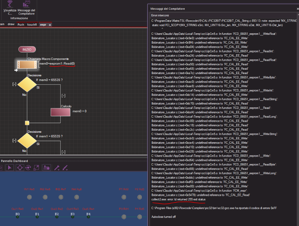

Good morning, I'm using 32mx575f512h, when I use the eeprom component and insert
read or write the compiler gives me the following error message,
Where am I doing wrong?

Solved, I checked the datasheet carefully and this microcontroller does not have the eeprom, but the flash memory, it would be nice if flocode would warn and not allow the insertion of the object.
