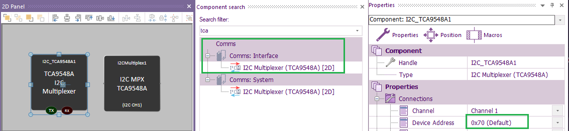

Then I have a question about the address bit propertis. How do I configure this? This is described differently in the help
Screenshot 2024-05-16 154132.png (8.31 KiB) Viewed 3370 times

there are two versions of this component.
What about selecting the component that is within Comms Interface?

Now I have understood. With the multiplexer TCA9548A I can select 1 of the 8 “qwii i2c connectors”.

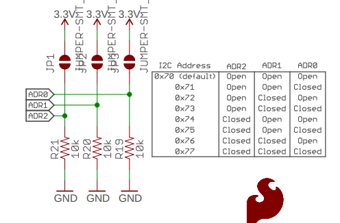

But I can also use 8 different multiplexers TCA9548A with these A2, A1, A0. Address selector.
With the other component I simply select the address in hex if I use several TCA9548A.
I will test the other component if i2c hardware works and post the result here.
how to change change the adress from the TCA9548A on the sparkfun device
Screenshot 2024-05-16 184941.png (43.81 KiB) Viewed 3354 times
