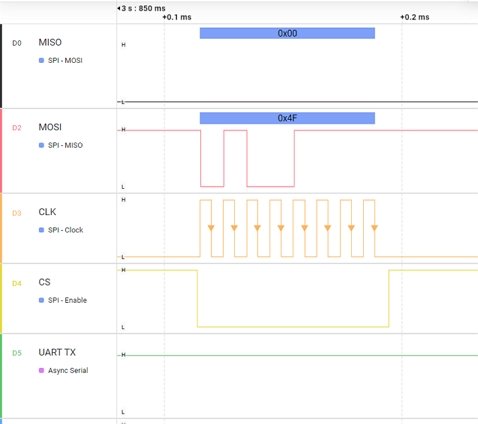

your comment about connecting an LED got me thinking, maybe the scope is not triggering
and slave is not working which is why I don't have any rs232 out of the uart.
So I connected the logic analyzer to investigate, and sure enough to my surprise there it was
this is when sending a char.
now when I try to receive 2x chars something strange is happening the master sends 0x55 twice
is this something normal or I am doing wrong?

And since the master is sending a char and then trying to receive another 2 chars , it should be providing clock for the slave to send the data , now the slave is not working but i have some questions,
Why the master is sending 0x55 when it should be only
Providing CLK and listening for incoming data ?
Also I was expecting the master to continue providing CLK until a sort of timeout kicks in , which it is also not happening
