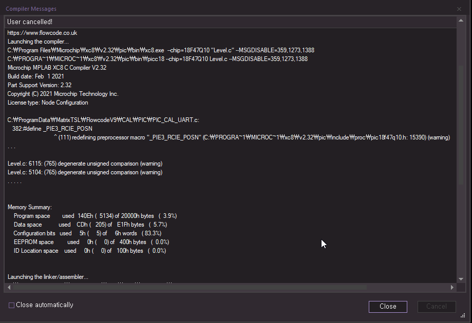

We will upload the result of the compilation. In addition, a flowchart is also posted.
Level.fcfx
(23.04 KiB) Downloaded 621 times

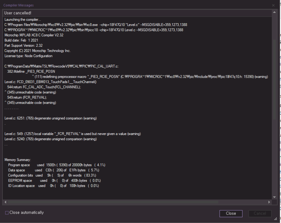

After modifying the program, we will upload the compilation result.
Level.fcfx
(23.5 KiB) Downloaded 595 times

Re: CAP Touch(PIC18F47Q10)
The Touch_0_Raw variable should ideally be of type UINT.
What values are you getting on the serial port?
