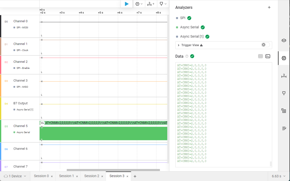

Posts: 2325
Has thanked: 724 times
Been thanked: 783 times
Re: UART "SendString" command problem
Hi Sasi.
I have just tried your UART_Test_2_NOT Working.fcfx on a 18F46K80.
The only difference is I set the internal osc to 64MHz ,whereas you are using external osc.
It should not make any difference to the results.
This is what the analyser shows for baud of 19200:
PIC18F46K80 UART.png (198.41 KiB) Viewed 5983 times
That would suggest there is nothing wrong with the UART SendString function on 18F46K80
Therefore I'm moving this topic from Bug Reports
