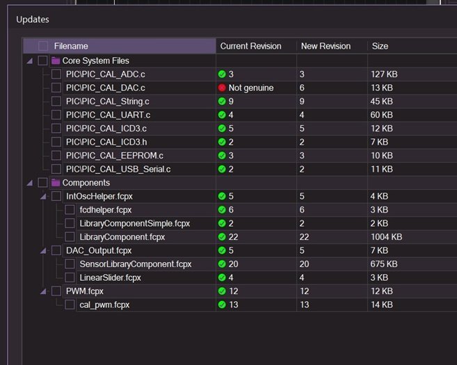

I am attaching the version of the components used: Regards,
Sasi
Sasi
