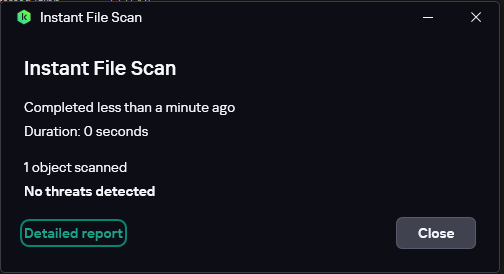

Hi all. attached is a signed version, so Hopefully it's now AV friendly.
I ran another scan since it has been signed.
Kaspersky scan on exe.png (18.52 KiB) Viewed 4850 times
Can you give it a go and let me know how you get on with it please.
Flowcode 16 Recent Files List v1.0.2.zip
(697.47 KiB) Downloaded 297 times

No problem on my W1o running Norton. It wasn't initially happy but did allow it.

Thanks Medelec35
Your latest deleted unwanted files perfectly
