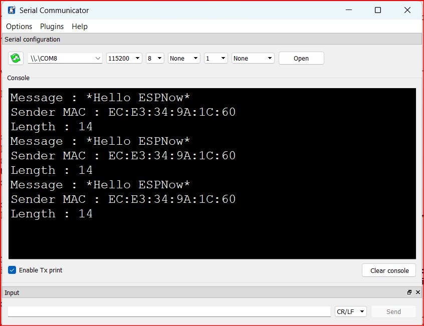

Test Files....
Screenshot 2025-10-19 194225.jpg (70.97 KiB) Viewed 12286 times
