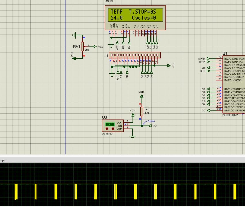

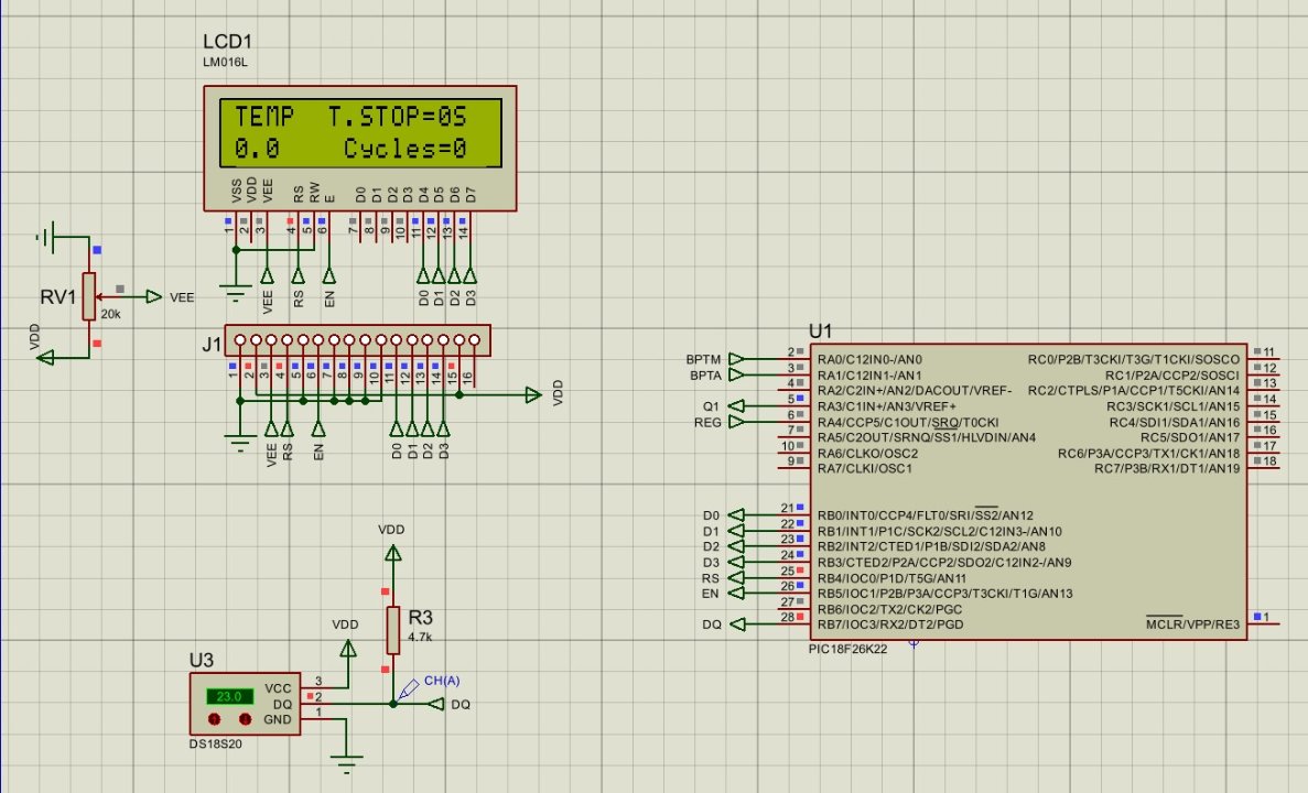

I created a flowchart using a DS18S20 (which I copied from the examples, but I don't fully understand it). It works in simulation under Flowcode 11, but not in Proteus.
If anyone has encountered the same problem, I would appreciate any information.

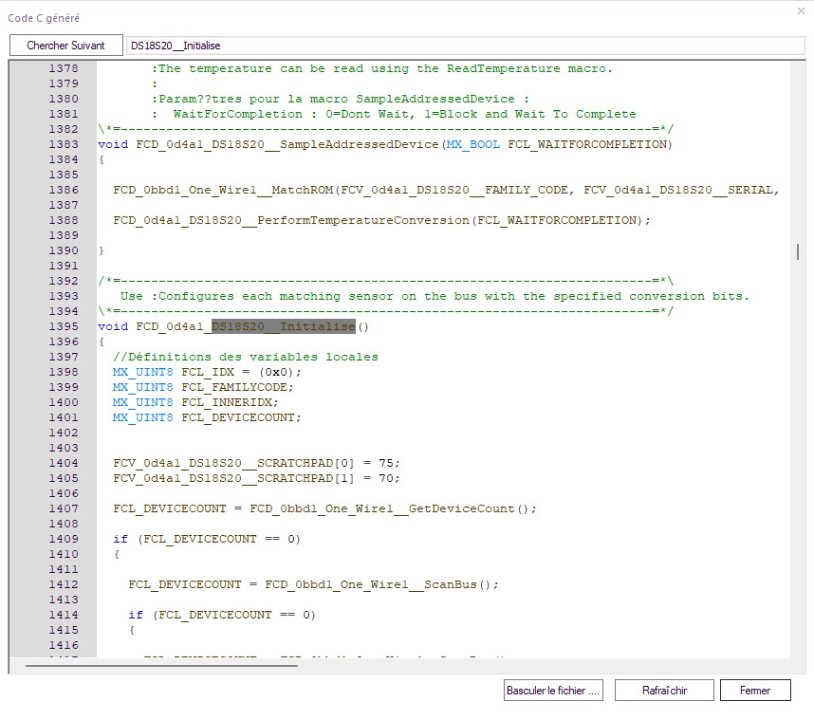

In your program the DS18S20 component (the library to read the temperature from the sensor) isn't linked to the OneWire component (the library to perform one wire communications).
Select the DS18S20 on the panel and in the properties change the LinkTo to point to the OneWire component.
I'll maybe see if I can make this link automatic to avoid this problem.

Thank you very much for your reply. Indeed, I hadn't connected the DS to the OneWire. It's done now, but it still doesn't work under Proteus. I don't even get a signal (on the oscilloscope) on the OneWire pin.
I'm wondering if there's an incompatibility between the DS and the PIC 18F26K22!
I asked Microchip, and they said no!
I'll have to redo the schematic with a 16F.
I'll keep you posted.
Best Regards
Luc

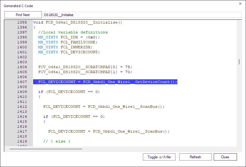

Hopefully all sorted for you now in v10 and v11 via Help -> Library Updates and a project reload. Fingers crossed :D
The way to tell if it's fixed is by looking at the generated C code, specically search for this function.
DS18S20__Initialise
This is working.
This is not working, note the use of the dummy in the function calls, basically the sensor is not correctly linking and calling the one wire library,

For information, I use V11.
You can see from the two images that it works correctly.
A GRRREEEAAATTT Thanks
Luc
