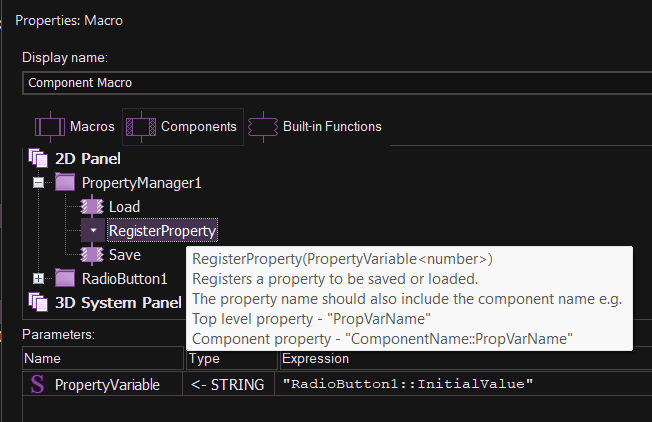

Right should be resolved now, I've cut out the sub components and now do the read/write directly and this seems to work much better and gives me much more control with what we are writing to the file so that's great and leads to less ambiguity with property values.
In your file you were using the string "InitialValue" but as this is a component property instead of a top level property this needs to be "RadioButton1::InitialValue"
I've fixed the tooltips for the RegisterProperty function so that this is also now more obvious.
Let me know how you get on.
