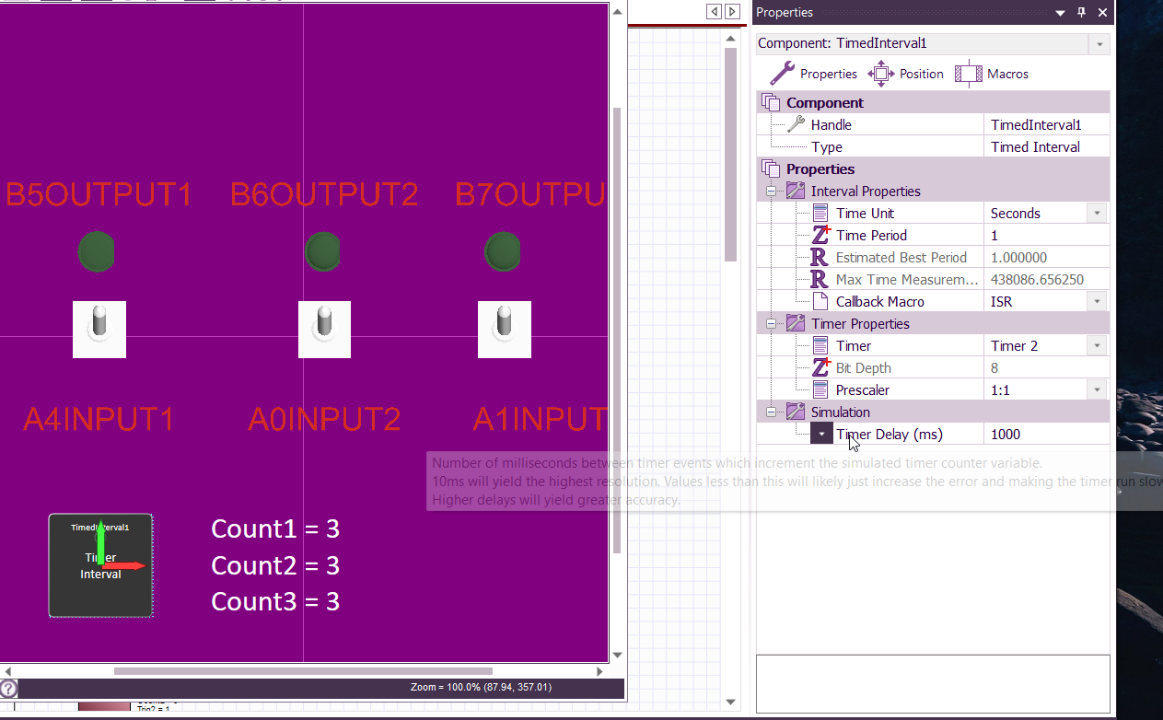

Posts: 2425
Has thanked: 778 times
Been thanked: 839 times
Re: Implementing a non blocking delay
Hi.
For my two pence worth.
Timer interrupts can be precise in simulation as well as on hardware
All you do is use the timed interval component instated of the timer interrupt command icon.
Then you set both simulation and embedded time within the the properties.
Timer Interval component 1.png (248.04 KiB) Viewed 5499 times
There is a bug within the timed interval for simulation only and I have added the simple get around you will see within the ISR call macro.
Try the attached. I have just modified Chipfryer27 example.
Thermaltimingjan_Example v2.fcfx
(27.13 KiB) Downloaded 242 times
