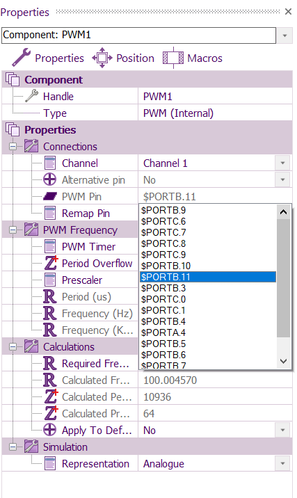

Hi, I am following up on this. I got things to work in my first application because I was using a single PWM channel. In my next iteration, I need to use 3 PWM channels. However, the dialog window to configure the PWM outputs on my 2D diagram has a limited list of pins and the pins linked to the PWM channels are not listed.
I am using a 44 pin dsPIC33EV256GM004 and it shows PWM1H on pin 14 (RB14), PWM2H on pin 10 (RB12) and PWM3H on pin 8 (RB10). Of these, only $PORTB.10 shows in the pull down menu. I don't see $PORTB.12 and $PORTB.14 I attached a screen shot of the configuration window as I see it on my computer. From the manual, it also says that the high speed PWM is not remappable.
Is it possible to access the pins I need or do I need to use a C-Code block?

Post by chipfryer27 »
Page 9 of the data sheet documents which pins can be used for PWM, not all are usable.

Currently the definition for that family is only targetting the Output Compare / CCP type PWM. I'll investigate how easy it would be to also add support for the further 3 high speed PWM channels.

Thank you for the detailed reply. This is all a bit over my head which is why I chose Flowcode in the first place.
In my first project (which is working), I used the PWM component and configured the PWM to $PORTB.10 and it is working fine.
My current PWM is configured at 40khz and I have a duty cycle range of 1500 counts (my master clock is 60MHZ).
Can I ignore the "high speed PWM" thing and just configure the pins with the PWM component? Will it work if I just choose pins that are available in the dialog box?

Yes the pwm channels and pins that are available now should all work fine without resorting to using any C code. It's just the high speed PWM peripheral that is currently unsupported which are the pins marked PWMxH, PWMxL in the device datasheet.
