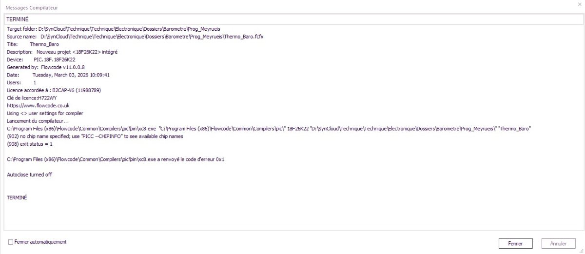

Regarding Proteus, I have the latest version, 9.1 SP4.
Now I downloaded it from my other computer (XP8 v1.45) and changed the compiler path. I received error messages during compilation. I uninstalled FC11 and reinstalled it. I also uninstalled the Picv2 toolchain and installed the v8_Flowcode Compiler (which I should have on the other computer). Now I can no longer compile. FC11 was probably uninstalled incorrectly.

I can now compile after a complete uninstall of FC11. But I still have the same problem: I don't have the file with the .cof extension.
