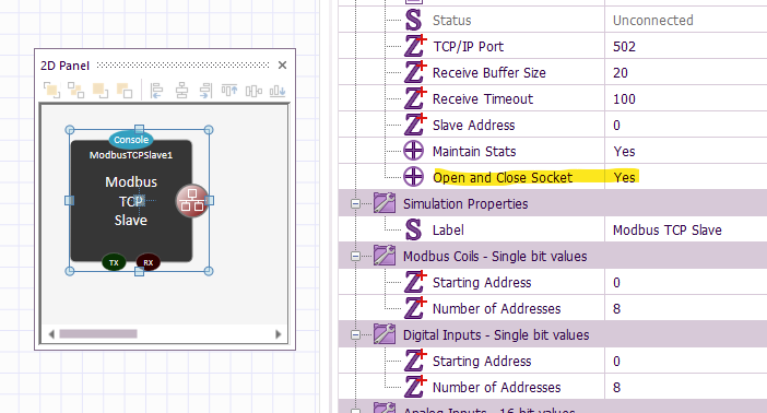

Here is the property I mean, If you don't have this maybe check the help -> library updates to see if there is a new version of the component.
Screenshot 2026-04-23 164335.png (53.58 KiB) Viewed 2602 times

Re: Modbus TCP read error
Post by seokgi »
It works well. However, errors still occur about once every 20 times.
