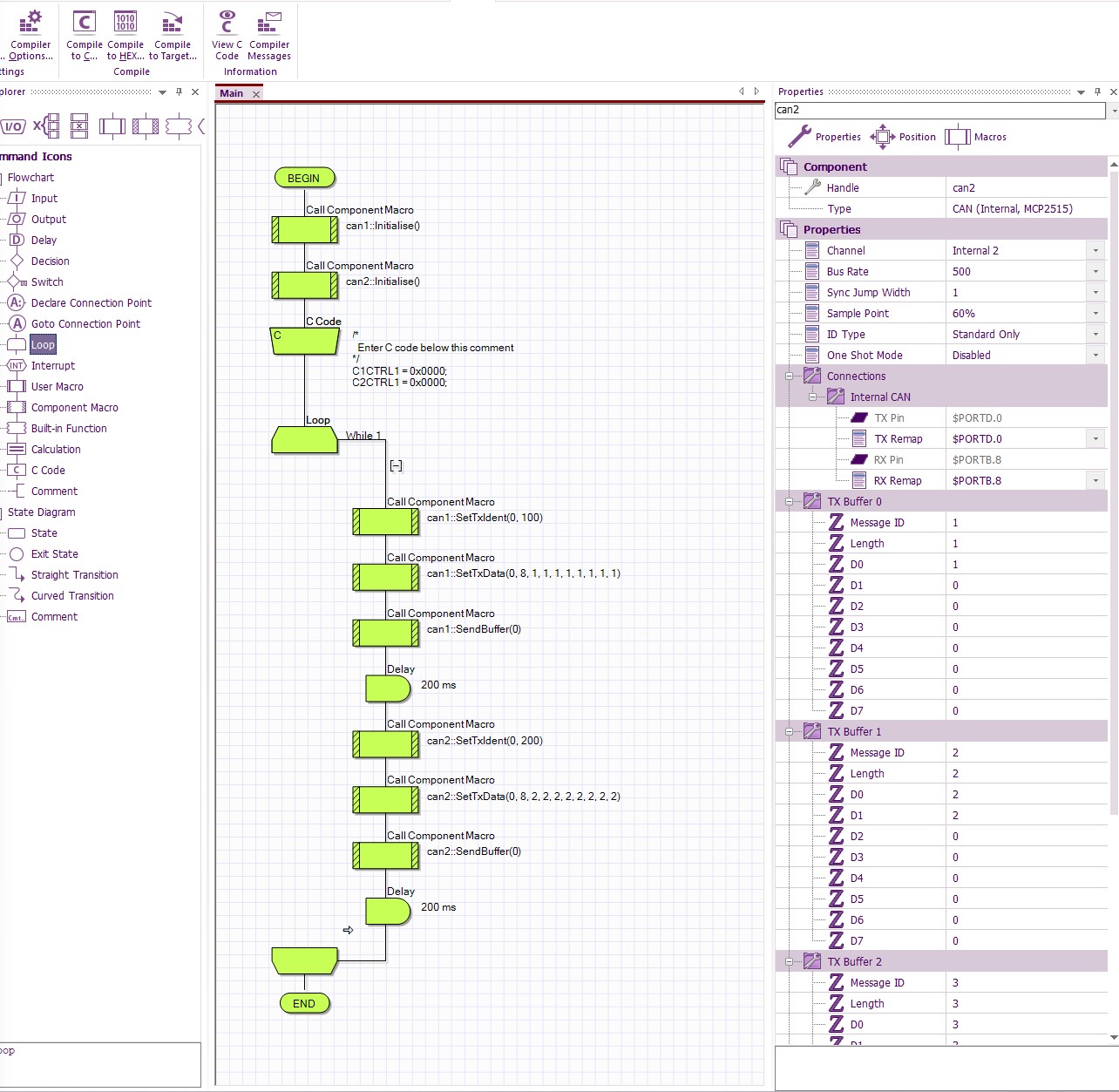

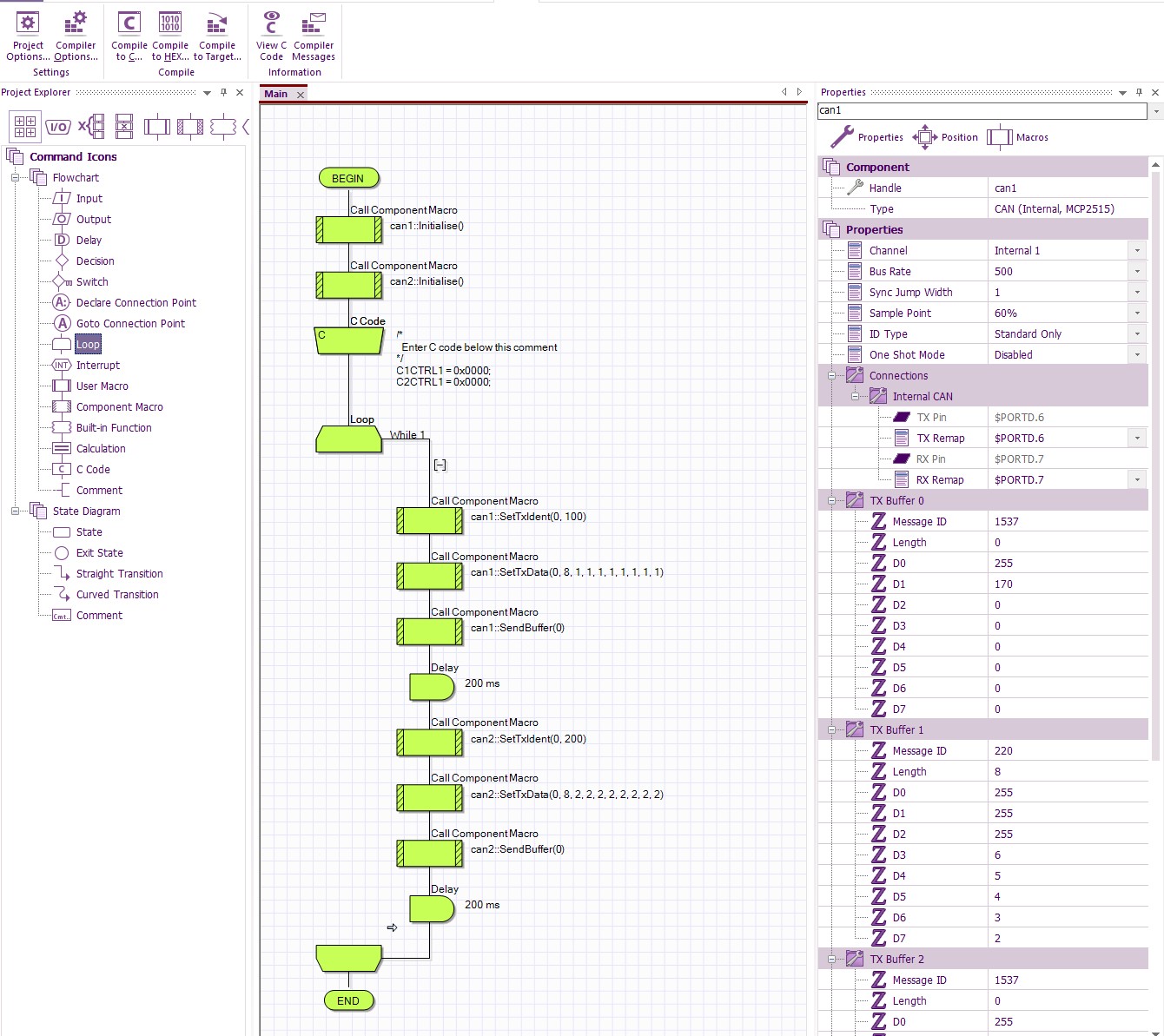

Hi I have problems using the CAN component.
I will use both channels Internal1 and Internal2 on an ECIO40P16 (DSPIC33EP256MU806-IMR chip)
Here is the test I am doing:http://ev-power.mine.nu/EV-POWER-NORWAY/FC/FC9_1.jpg
http://ev-power.mine.nu/EV-POWER-NORWAY/FC/FC9_2.jpg
see the attached project file
can1 works fine but can2 does not work. I need help and suspect that there is a fault/bug in the component.
I am using FC9 but get the same error in FC7
CANTest1&2.fcfx
(17.67 KiB) Downloaded 148 times

Another problem is that if I initialize can2, can1 becomes very unstable and is unable to read can messages as it should.

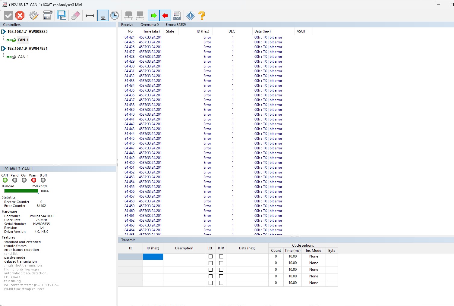

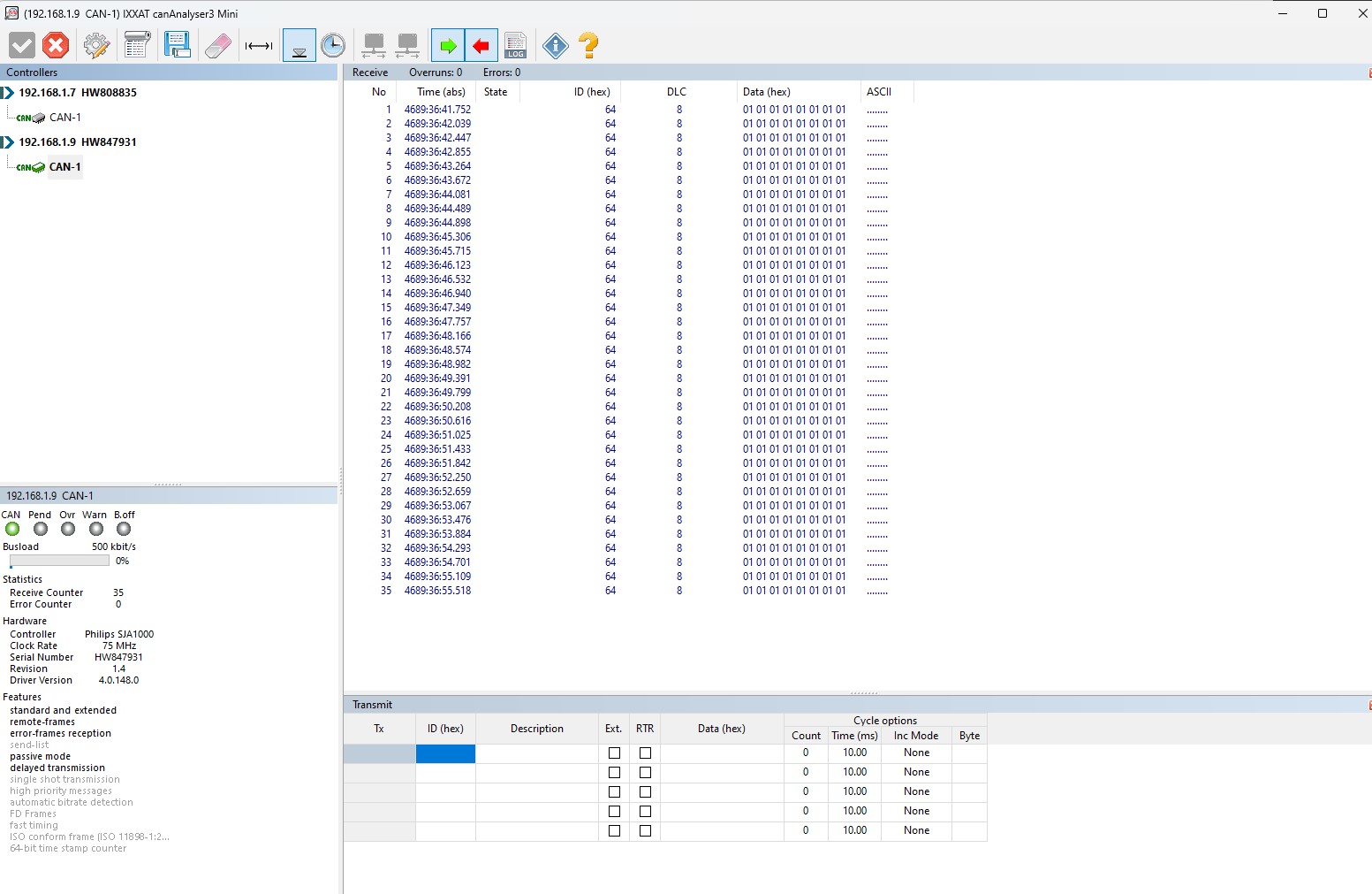

Here is the FC11 test program attached.
canbus1 becomes like this:
http://ev-power.mine.nu/EV-POWER-NORWAY/FC/can1.jpg
canbus2 becomes like this:
http://ev-power.mine.nu/EV-POWER-NORWAY/FC/can2.jpg
In addition, canbus1 becomes worse and more unstable at reading canbus messages on the bus when canbus2 is initialized. But sends them just fine.
