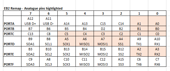

Could it be the e-blocks2 port remapping that is causing confusion?
Posts: 2321
Has thanked: 645 times
Been thanked: 855 times
Re: Free Target E-Blocks2 STARM Programmer failing to compile in FC11 Free Version
Thanks Leigh, Yes could well be the cause.
Here's the remapping guide for the E-block board from ST Port pins to E-blocks Port Pins if it's useful.

Hi everyone,
Thanks for all the support.
I have verified the pin mappings for my setup PWM Channel 5 (TIM2_CH1) on PORTD5 of the E-blocks board correctly maps to PA5 on the controller, and E-blocks PORTA0 (my LED pin) maps to PA0. This completely matches the E-blocks pin mapping guide.
