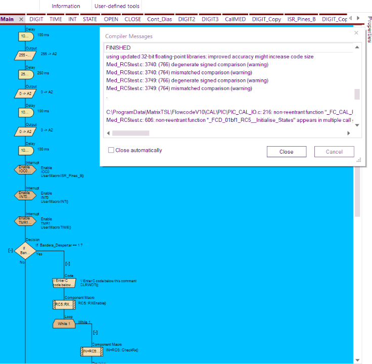

I've been working on this project for a while. I started by importing a 4-digit TM1637 example (Flowcode8) because I couldn't get it to work in Flowcode 10 and 11. In fact, I received your help at that time. I haven't tested it since to see if it was a bug or, more likely, my own mistake. From there, I've added functions like sleep, WDT, RTC, Valve, Display, Relay, and Batteries. I'm using all the pins of a PIC16F1847. Now I was adding low-power communication and initially thought of using the RC5 (KY-022), eliminating an IR photodiode and replacing it with the KY-022. However, when I compile, I've received different messages. Since I'm waiting to get the component, I took the opportunity to start the flowchart while I wait for it to arrive. Yesterday, I was doing some testing and managed to get it to compile, but it sends several messages that I'm not sure will affect its operation. I simplified the program, keeping only the last message it sends. I appreciate you looking at the messages and the flowchart, so I can get your opinion.
I even made adjustments in the RC5 properties, setting the frequency to 38 kHz and the pulse time to 945, according to the KC-022 specifications.

The messages are warnings (not errors) - but are indication of something wrong in the code.
The problem seems to be in DIGIT_RC5 where you have (for one instance) 'if command < 9999' - however command is a byte (0..255) - so the comparison may give incorrect results (similarly with if command < 999(

In STATE:
You have
FLASH = 0
LOOP count 7 TIMES using FLASH
FLASH = FLASH + 1
If you count using a variable - you don't need to set it to 0 (it does (for(flash = 0; flash < 7; flash++) { ... )
The increment means that the flash won't occur 7 times - so would be best removed (and the loop count set accordingly)
... or ....
flash = 0
whle (flash < 7)
flash = flash + 1
Which does the same thing..

Thanks Martin, se eliminaron las advertencias, estas que quedan no afecta ? voy v ver si consigo 1 kc-022 para probar si flowcode lo acepta cambiando solamente las propiedades
C:\ProgramData\MatrixTSL\FlowcodeV10\CAL\PIC\PIC_CAL_IO.c: 216: non-reentrant function "_FC_CAL_Port_In_DDR__x" appears in multiple call graphs and has been duplicated by the compiler
Med_RC5test.c: 607: non-reentrant function "_FCD_01bf1_RC5__Initialise_States" appears in multiple call graphs and has been duplicated by the compiler
Enrique

The 'duplicated' by the compiler warning means that there are multiple instances of the code (the function Initialise_states) generated - which will give larger code. It 'shouldn't' (famous last words) cause an issue - but looks to be an issue with the component. The source isn't currently available on the Wiki - so can't check this.
Note - it would be an error to have a function that is called by a function it calls (or from an ISR) if it has some state variables (the non-reentrant warning). Usually you would attempt to remove this error (by re-structuring or re-factoring the code) - but the compiler also attempts to do this by creating 2 (or more) instances of the function.

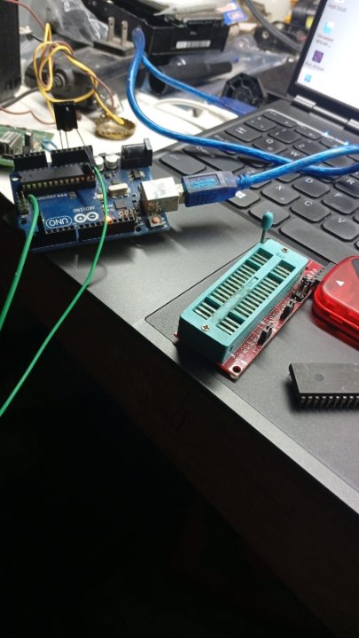

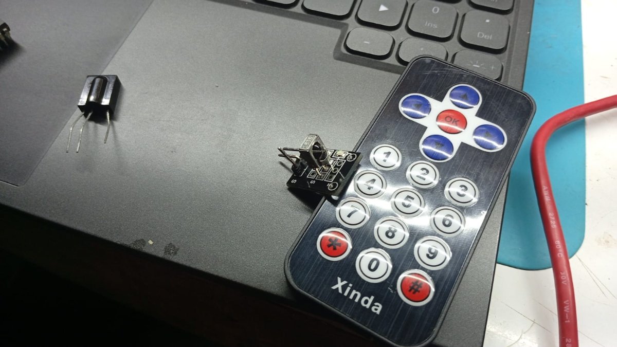

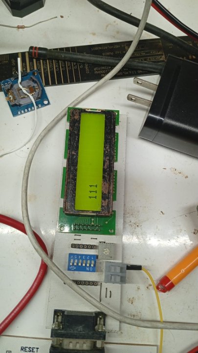

I obtained two modules, one 36 kHz (TSOP31236) and one 38 kHz (KC-022). I also ordered 10 units of this model. This includes a small IR controller. I modified the flowchart properties of the component and the timers for testing. I added a 16x2 LCD display to see the program's status and what it's not doing: 0 - starts, 111 - no data detected, 222 - data detected and displayed. To avoid mixing programming sequences, I used a PIC16F1939 and a PIC16F887. I couldn't receive data from either of them. I also tried the example program published for Arduino (RC_Tests).
- RC5_Tests (1).fcfx
- Arduino
- (14.62 KiB) Downloaded 30 times
- RC5_Tests1939.fcfx
- PIC16F1939
- (14.89 KiB) Downloaded 31 times
- modulos IR.jpeg (127.56 KiB) Viewed 1833 times

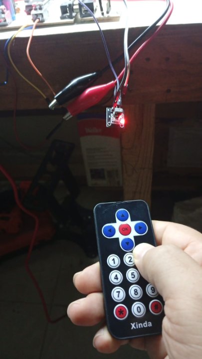

I used it to test the small IR remote control that included the 38 kHz sensor and I made a TX control with flowcode
- Prueba con el de 38KHZ
- Probando con el Control IR .jpeg (37.76 KiB) Viewed 1832 times
- Sin deteccion
- No detecto datos entrantes.jpeg (56.15 KiB) Viewed 1832 times
- RC5TxV10.fcfx
- TX_36KHZ
- (13.4 KiB) Downloaded 34 times

- Ejemplo de Arduino.jpeg (52.6 KiB) Viewed 1832 times

I found one of the sensors in the toybox and a small (hopefully RC5) transmitter.
First attempt - failed (error in Timer function).
Compiled the example which seems very similar (except it has a TimerCallback - that does nothing) - and it doesn't work (nothing output
Added a TimerCallback (which doesn't seem documented) - to my code - still won't compile...
Unfortunately the source foe the component isn't currently available on the wiki - reported this - but I'll play some more later. The LED flashes on the IR board - a good start? Now the LED is on constantly?
So at the moment - I'm stumped for using the component. Will play a little more later...
