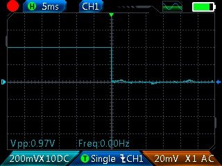

Connected a scope to a zone input on my control panel and 0v.
Panel input is normally high, going low when a PIR / detector triggers (N/C detector) and I set my scope for a single shot on a falling edge.
As you can see a clean transition so no real need for any debounce in my chart.
