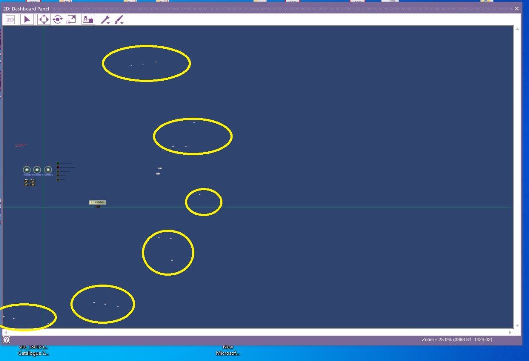

zooming out of the panel (by accident) it appears that there are items on the panel ? zooming into the area nothing is there ? - see attached.

Here's a brief explanation that may explain some of the issues you're seeing:
Up to v5 of Flowcode, there was only 1 "panel" and it was a 2d panel rendered using "GDI". This was replaced in v6 with 2 "OpenGL" panels. OpenGL is a 3d environment and although there were 2 panels ("2d" and "3d" in v6 onwards), these were essentially 3d environments. Special viewing and processing tried to mimic a 2d view in the "2d" panel, but it was a compromise and there were certain instances where the "camera" (i.e. the viewpoint of the 3d "scene") was in front of some of the components, meaning as you zoom in to the panel, these objects would disappear from view.
In v9 of Flowcode, we added the ability to display native GDI 2d objects on the 2d panel. Behind the scenes this was a big challenge, but we wanted to introduce better ways of displaying data and to allow nicer panel UIs to be created. As a result, zooming and moving objects on the 2d panel is slower than previous Flowcode versions. But we feel this is worth it as it has allowed us (and you) to develop really nice-looking panels (for example, see here).
We are currently working to have a true 2d panel in future versions of Flowcode which will not be beholden to the compromises we have had to make in the current version.

My PC is a retired 3D cad machine, did wonder in the back of my mind if there could be some compatibility issues, wouldn't be the first time.
Now i know what is happening and why its not an issue.
