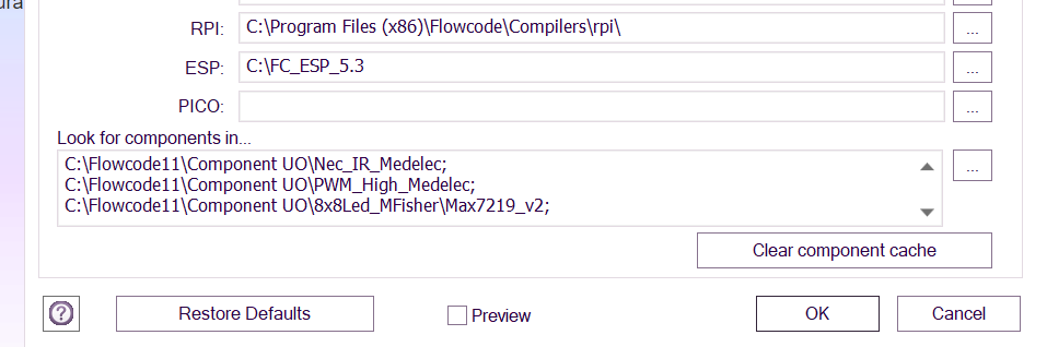

Hi Martin (mfisher)! :)
Some time ago, you created the Max7219_v2.fcpx component for Flowcode 8. It still works perfectly in FC8, but when I add it to FC11, I get a lot of errors and I’m unable to compile.
I also have a Max7219_v9.fcpx file (I have no idea where I got that one from 😊), but unfortunately that one doesn’t work in FC11 either.
I have a program that I would like to edit, and I would really prefer to do it in FC11.
Would you be able and willing to modify one of these files so that it is compatible with FC11 and can be used there? It was a really good component for controlling up to 8×8 MAX7219 displays, and I would very much like to keep using it.
If you can and are willing to have a look at it, I would really appreciate it. I Guess you have both file, don´t know hvat the difference is in these two, otherwice I can att. them
Many thanks in advance!
