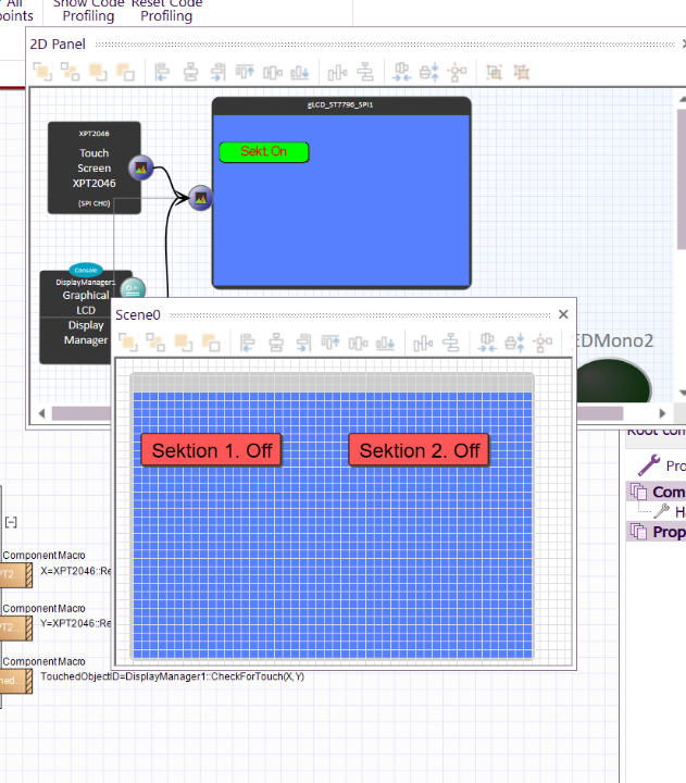

I am starting on a new project, using displaymanager. I have to be able to switch an output on and off by pressing a botton, and I have to create some more botton, this is only the start. As you see in Scene0 I have made two botton, in the beginning when I simulate borth botton was shown in the display on the 2D screen, also when I compile to chip and I was able to switch the output on and off by toggle the botton, but suddently the disapear from the 2D screen and when I touch the one botton both output switch on. What Have I done wrong please?

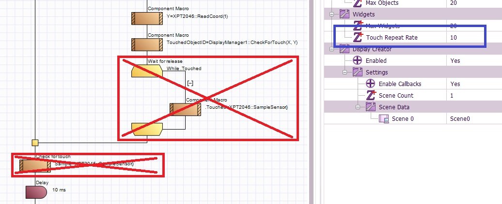

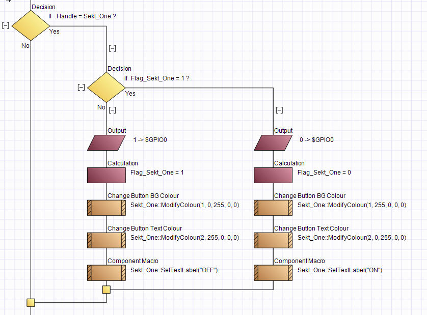

To change the button colour you simply call the Button component macro ModifyColour with index 1 for the background colour and index 2 for the text colour. The Redraw parameter decides if the colour change is drawn immediately but this will remove the default text so might be better to just use the text set function to redraw after the colour change.
Here's an example.
Screenshot 2026-10-01 110018.png (84.14 KiB) Viewed 293 times
There is some wierdness for me on my home PC so I'm seeing if I can replicate with a fresh project.
You shouldn't need the while touched loop unless you never want repeat touches and the second check for touch in your main macro isn't needed. If you need longer delays between touches then instead increase the Touch Repeat rate property of the Display Manager component.

However, as you can see, even though I have two buttons in Scene 0, only one of them appears in the display in the 2D panel. The same thing happens when I start the simulation.
When I compile the program and run it on the chip, the colour change and text work correctly, but the display is extremely slow. It also looks as if button 2 has somehow “exploded”. The actual button is not visible, but the text is scattered across the bottom of the display.

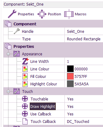

The line under and to the side is the drop shadow for touchable items. You can turn it off if you like.
Screenshot 2026-10-01 195403.png (20.7 KiB) Viewed 231 times
You could add a small rectangle on top of the button and change the colour of that. The smaller the area to redraw the faster it will be.
