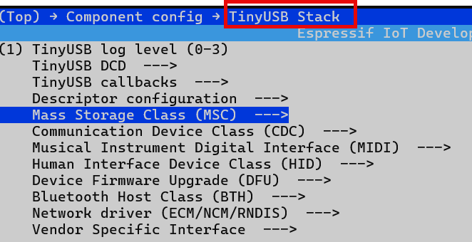

A long time ago, I added TinyUSB to the “menu config” on my ESP32-S3 and set it to use USB.
There's also a setting for Mass Storage Class (MSC).
Maybe this will help?
