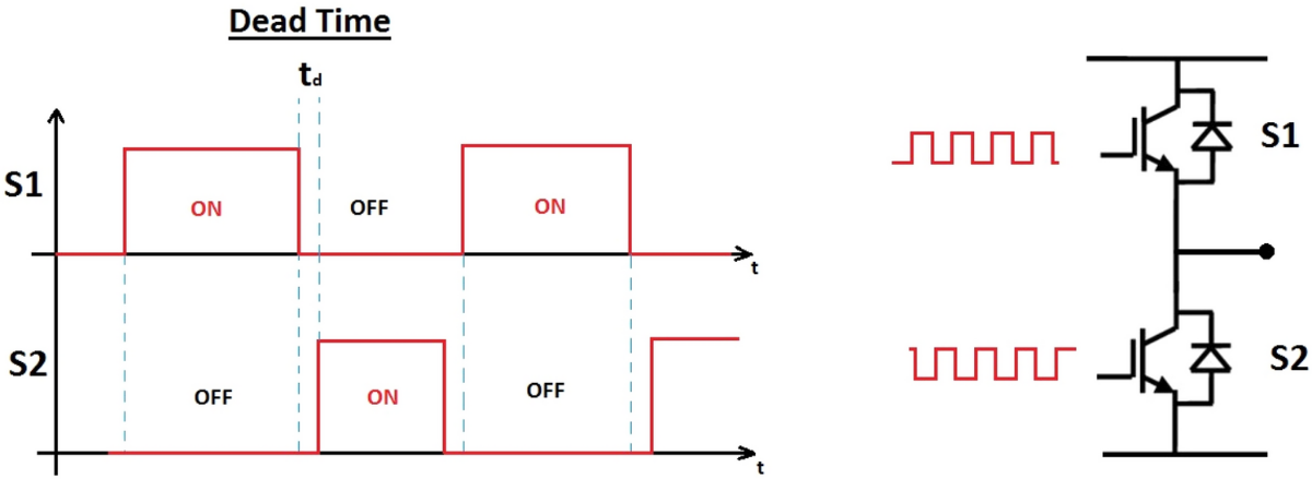

Hello. I want to use push-pull PWM functionality in power electronics. I want to change the frequency, PWM width, and dead time of the push and pull signals. In a normal PWM application, I do this with a single output. However, in a full bridge application, there are two outputs, and these two PWM outputs are phase-shifted. I would appreciate it if you could provide either a component for such an output or a method for creating a phase difference between the two PWM outputs.

Would a simple inverter connected to the same pin as S1 and the input of transistor S2 not do it? Now you get an inversion of S1 with minimum delay, freeing up your uC for other tasks.

Some chips have dedicated H-Bridge compatible PWM and where they have this we have a H-Bridge component that can work with them to do all the functionality your asking for. i/e/ synchronised PWM outputs and dead time etc.
However the PIC18F47K42 does not have this feature and using PWM alone it wouldn't really be possible. Good news is the chip does have the complementary waveform generator peripheral. In fact it has three of them!
You show the circuit for a half bridge but also mention a full bridge which would be 4 output channels.
