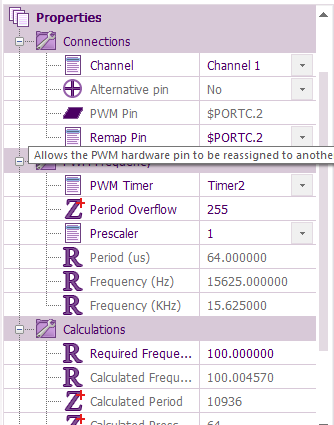

Hello
i cant working PWM output in PIC 16F1718
pleas help

The problem is that I have a very simple chart that should produce Pin C1 or C2 a PWM. But after compiling and programming, there is no PWM wave. Micro works because I can have led blink from pin B0

Re: PWM for PIC 16F1718
I think I have spotted the bug in the device definition file and hopefully on downloading the latest updates the problem should be resolved.
