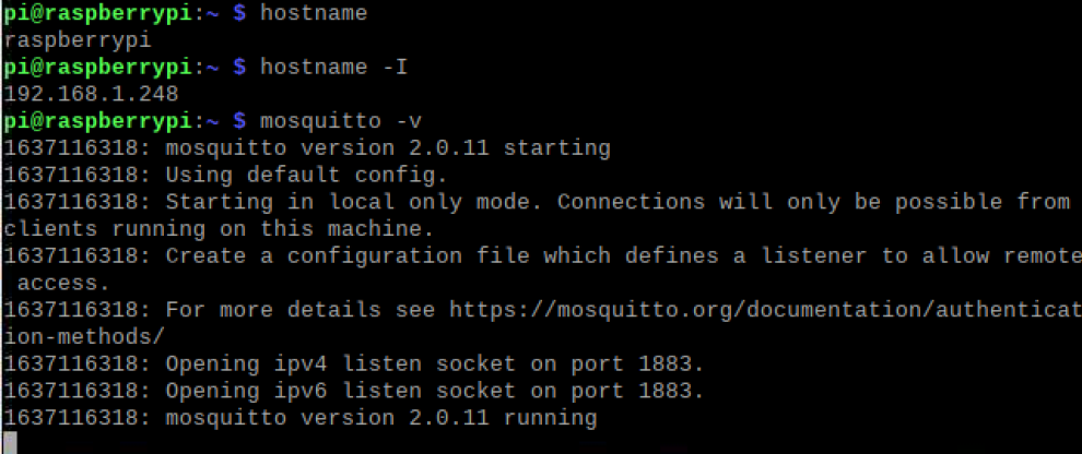

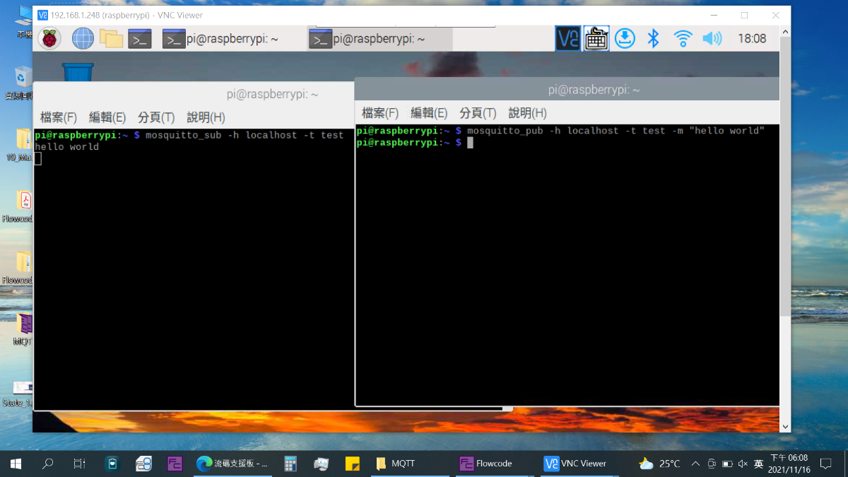

我用 Rpi4b 是我的 Mqtt 經紀人 (https://www.flowcode.co.uk/wiki/index.p ... QTT_Broker)
Picture_2是我的 Rpi 設置。(MQTT 經紀商測試和 IP 位址)

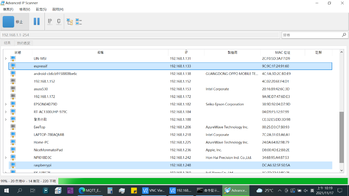

The first thing I would do is check that both the ESP32 and RPI can be seen on the network.
I would use a network utility tool.
Then I would check that RPI IP matches up with the stated IP within IOT Made Easy component.
As you have set up a broker name and password, within IOT Made Easy (Pi,a0953530662), have you set up the same name and password within the RPI?

Re: MQTT_ESP32_AppDev did not work.
Also...
If you stop the mosquitto server as a service, then run with the command
you will get on screen messages that will help,
such as when the client connects etc..
mosquitto -vsuch as when the client connects etc..

Reply to medelec35 :
First, thank you for your reply. I followed your suggestion, check my hardware.
(1) Rpi and ESP32 both can be seen on the network. (2) Rpi IP address matches up with the stated IP within IoT Made Easy component. (3) I found I didn't set up the broker name and password, so I changed the component properties.

Thanks you for you reply!LeighM wrote: ↑Tue Nov 16, 2021 3:32 pmAlso...
If you stop the mosquitto server as a service, then run with the commandyou will get on screen messages that will help,Code: Select all
mosquitto -v
This was the screen message, is it got some wrong ?
Mosquitto version 2.0 and after requires a bit of additional configuration to enable remote access.
The clue is the "starting in local only mode"
The details are available here.
https://mosquitto.org/documentation/aut ... n-methods/
Fingers crossed
