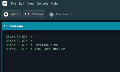

I did a test with ESP32TTGO and there is 2 solutions.
  • only replace delay by
    vTaskDelay(1);
    in C Code in your loop.
    To be able to use 1ms don't forget to adjust to 1000hz in menuconfig or in SDKconfig file to "CONFIG_FREERTOS_HZ=1000" to be able to get 1ms delay, if not, the frequency will be 100hz so min delay will be 10ms.
    On the console you will see only this, with nothing below tick rate, it me that the ESP don't reset.

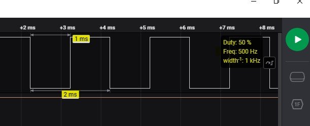

  • Start a periodic task every 1ms using with the code below in C code
    xTaskCreatePinnedToCore(&FCM_Task1, "Task1", 2048, NULL, 3,&FCV_HANDLETASK1, 0);
    Last parameter is the CORE to use , you can choose the CORE to use for this task by replacing the last parameter by 1 for CORE1
    With this solution, you main task will not be affected by task1 so you can do others things in main task without delay. Of course in this example I add 10ms in the main task because there not others things to do.
    I added a Pin toggle on the task1 and the counter is also incremented and I added sent absolute time to console, as you can see the pin is toggle every 1ms even with 2 or more things to do. Of course if for example you want to do many things and the time is more than 1ms it will no work well
    the Pin is toggle every 1ms as you can see below. It mean that the counter is also incremented every 1ms.
    toggle 1ms.jpg (15.23 KiB) Viewed 7455 times

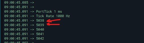

Xtask test1.fcfx
(17.27 KiB) Downloaded 705 times
Absolute time is printed on console every 1ms too
5038ms then 5039ms etc...
absolut time.jpg (13.63 KiB) Viewed 7453 times
