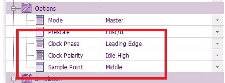

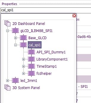

If the clock phase or polarity is incorrect then you can try editing this by doing the following...
Under View select Component Debugger and on the window that appears tick the "Expose full component tree" property.
Next use the drop down window at the top of the properties window and close the Base_GLCD so you can select the cal_spi component.
Try editing these specific properties one at a time to see if they make any difference.
