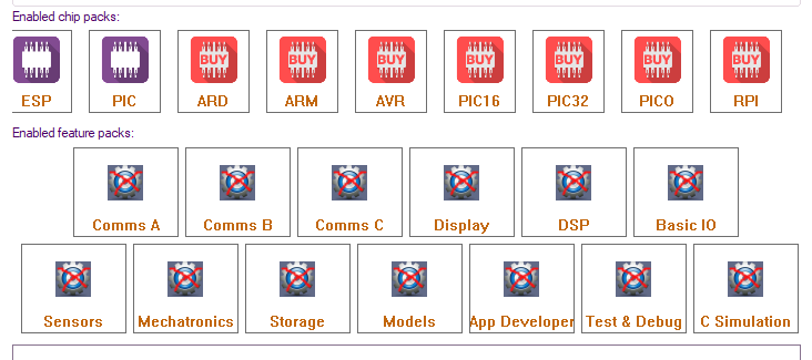

Yes, I think you are right. So, last night I purchased Communications Pack A, Basic IO and Display.
I am using an I2C bus, push buttons and LED display and I still can't access those components in my program. When I try to access the components in the "components library", there is a yellow exclamation point. And I get a message that my license does not cover that component.
I have tried to reactivate my license and enter the new key that I saw on the order screen (after I placed my order) but it is still not working.
Attached is a pic of my license status. For some rerason, the new packages are not showing up. I have tried restarting Flowcode and my PC numerous times and using the help section to try and get the new key recognized.
So, what steps should I take at this point?

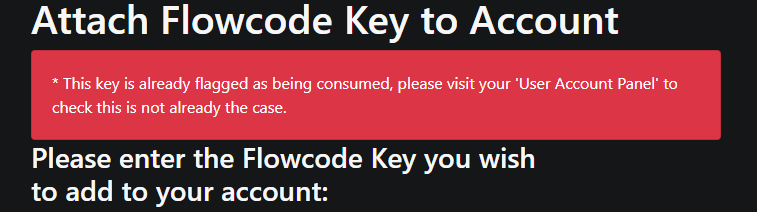

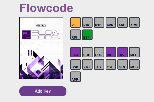

Yes, I have tried all of that -- I have used the help icon and clicked on all of the licensing functions and tried reentering my key information, etc.
In addition, I uninistalled and reinstalled Flowcode, but it did not solve the problem.
My online account information shows that I do own the addtional licences (see below). However, when I enter the key that I was given last night when I purchased the additonal licenses, I keep getting the red box error message as shown below. Is there something else I can try to fix the problem? Thanks.

Your online overview shows the packages you mention as being purchased so that looks alright. Did you attempt running Flowcode as administrator when adding the license? (I trust you use the same login when adding the license that you used when displaying the on-line status?)
Re: Flowcode License is not beting recognized
Hi kersing,kersing wrote: ↑Tue Aug 09, 2022 9:38 amYour online overview shows the packages you mention as being purchased so that looks alright. Did you attempt running Flowcode as administrator when adding the license? (I trust you use the same login when adding the license that you used when displaying the on-line status?)
Brillant! That worked to run it as administrator. It finally loaded all of my licenses. I should have thought of that, but it had run fine before without running it as Admin.
