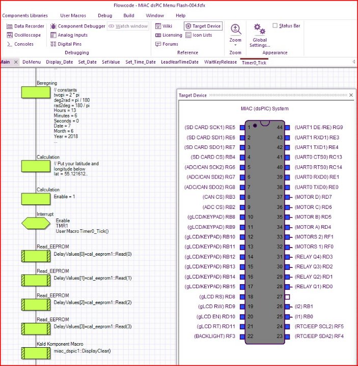

Does anyone here know how to change MIAC dsPIC to dsPIC BL0032-1 in FlowCode V9
So existing PIC circuit with encoder can be used for a dsPIC BL0032-1
MIAC dsPIC to dsPIC BL0032-1.jpg (119.4 KiB) Viewed 1377 times

The first step will be to change the target device via the "Build...Project Options" menu.
Once that has been done, you will probably need to alter the connections to any components so they are connected correctly as per your new hardware configuration. You may also need to pay attention to any I/O and interrupt icons too.

TO Steve-Matrix
Thank you very much.
I do as you have described :-)
