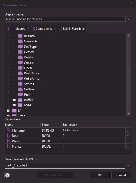

Re: App Developer build in function File
Hi Ben, Hi Steve
Thanks a lot.It's working fine now.
With the part "if file not can be open, then create", I understand.
And that there is no command macro for file close so I use file open but with parameter 0 for read and write.
I suppose that's what Ben means.
I will continue to save and open large amounts of data in arrays.
to close the file
to close the file

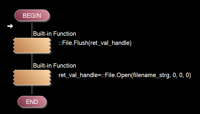

Use the "flush" API call to close the file for reading/writing as in the example.stefan.erni wrote: ↑Wed Sep 21, 2022 12:59 pmAnd that there is no command macro for file close so I use file open but with parameter 0 for read and write.

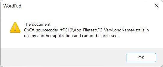

Hi Steve
If I use the example with the flush I get this message. So I have to close FC and then I can open the file.
I don't know exactly what I'm doing wrong that it doesn't work for me on my computer.
Hi Steve
Now it's working nice to close the file.
As you wrote flush and open with 0,0,0
