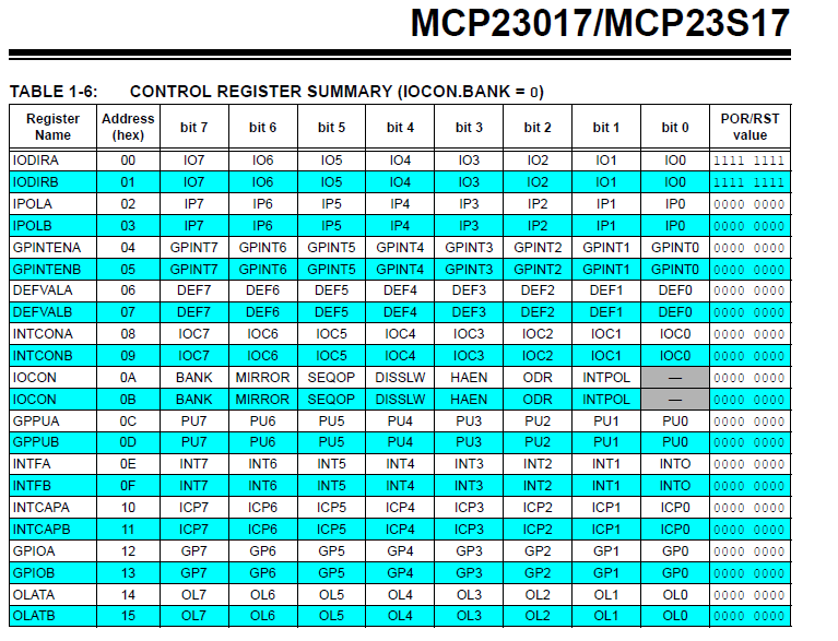

Re: FLOWCODE 9 MCP23017 PROBLEM
Hi David,
I just started playing with the MCP23017 according to the datasheet you have to set
Port B in your case to be an OUTPUT, this is done by writing the IODIRB register.
Putting a value of 0 will set the entire Port B to be an Output.
Working fine on the STM32, I hope this helps.
