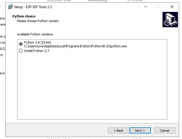

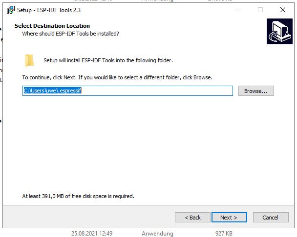

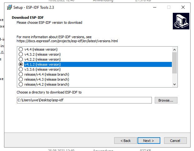

Before I reinstalled, I had uninstalled everything relating to ESP32 first.
That included python & git.
I always used the python 3.7 version since I had no issues with that.
For the paths, I used the paths that are in the install guide.
i.e C:\esp-idf & C:\esp-idf-tools
I remember having issues if left as the default users .expressif
4.1.2 (release version) is the version I used.
You should be able to use any 4.1 version e.g. 4.1 release branch,
Has your reinstall worked, or do you still have issues?

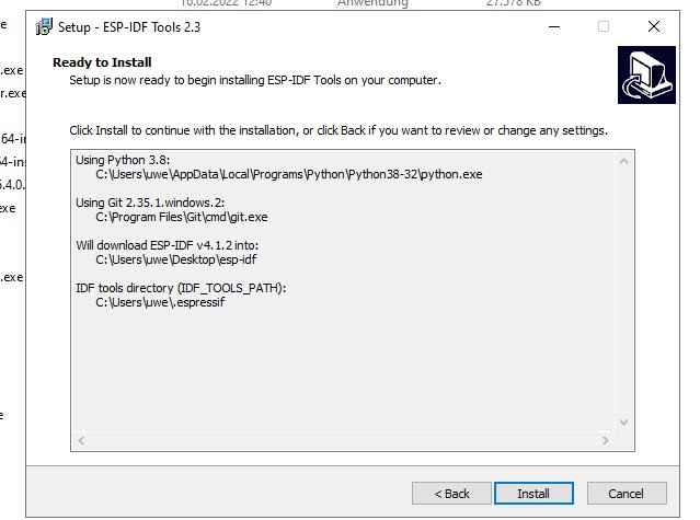

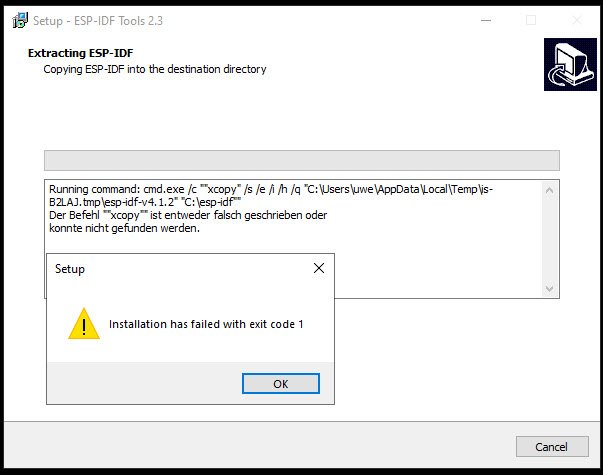

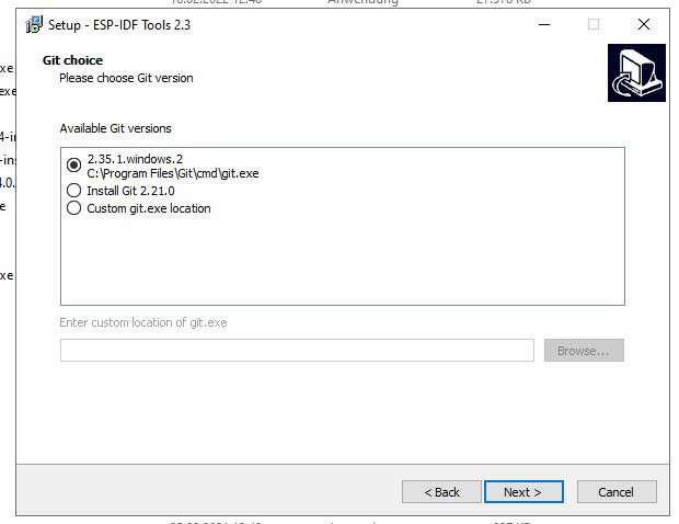

Hello medelec35
tried to install the suggested versions and got this error again.
greetings
SpeedPic32
Fehler neu.jpg (31.32 KiB) Viewed 8650 times
Setup Log 2022-02-20 #005.zip
(3.81 KiB) Downloaded 670 times

Do you have an antivirus running that could prevent files from being copied?

xcopy missing? Which Windows version are you using?

i am using windows 10.
can't the error also come from the installation routine?
I have found Xcopy several times on my computer.
Greeting SpeedPic32

Hello Matrix Team
I cannot install ESP32.
No matter which file I use, it no longer works.
Should I uninstall everything including FC 9?
I need professional help now.
Error code 1 means that there is no file to copy in the directory.
The complete content of the location esp-idf should be in there.
Greetings SpeedPic32

No - you should not need to uninstall Flowcode. The ESP toolchain is totally separate. Also, it is not ours to control and maintain, so we are not in a position to change it when things go wrong.
Have you looked on the Espressif website to see if anyone there has had a similar issue or solution?
Other than that, perhaps some other of our users can help?
Have you ever had this install working before? If so, what had changed with your PC to prevent the installation now?
