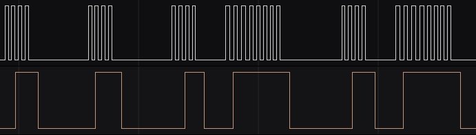

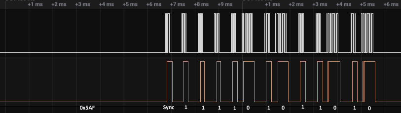

I've been having a bit of a go with some code to drive these modules and here is a simple transmit program that will allow up to 16-bits of data to be transmitted. This could form the basis of a component but I wanted to put it out there first to make sure it's what is required and that it's working for people. I hope it's compatible with the HT12A and HT12E encoder/decoder ICs as I based it on their protocol.
The timer interval component needs to be setup to give a decent carrier frequency, we're ideally aiming for around 38KHz (13us * 2) but on my test PIC this is running a fair bit slower around 18KHz probably due to the amount of code inside the interrupt macro. It still is working ok but I will need to tailor this for my receiver so it knows what sort of delays to expect. We could add an autobaud preamble into the transmitter code which might allow the RX code to lock on a bit better and not need precise known timings. I'll investigate this. I might just be able to use the timing of the sync pulse.
Please note I had to add antennas to my RF boards, I used single core wire measuring 173mm and just soldered this onto the antenna holes on the PCB.
Top trace is the TX data and the bottom trace is the RX data.
Receiver code hopefully coming soon.

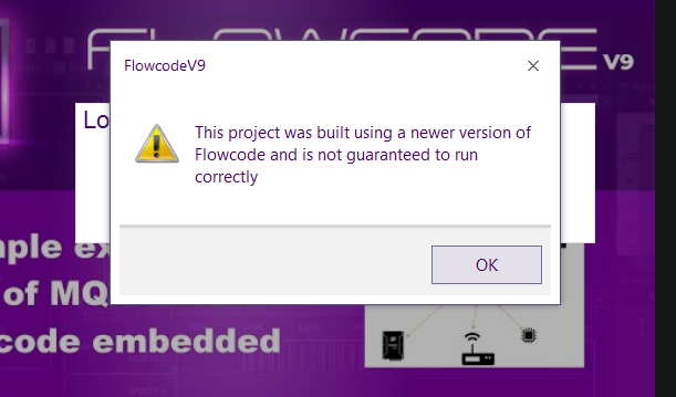

Ok Ben when I open your testprogram, I get this message and the program is loooong time to load, it start and look correct but do you think it will work?
I have update.

Sorry the FC version should be fine, we've been working on a minor update to v9 and I must have built the examples using that but nothing should cause any problems between that and the current release. Odd it's taking a long time to load.

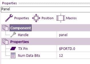

The pin is provided by the top level properties, either click on a blank area of the panel or use the drop down at the top of the properties window.

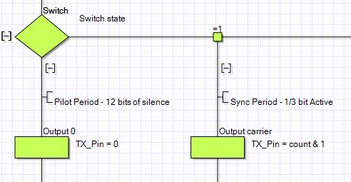

The pin is driven inside the TimerInt macro as part of the state machine. The TimerInt macro is called by the timer interval component on a regular interrupt driven tick.

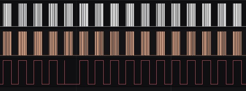

I've managed to tweak things and get them a bit more stable now. Rather then picking up say one in twenty packets we now receive most packets correctly. There's still the occasional loss of data due to a smaller then usual sync pulse and so the RX interrupt could be run a bit faster to overcome this.
Here we have TX data top, RX data middle and RX decoding bottom, most packets are decoded correctly but the dropped packets can be seen by the spike.
Here is my current RX project with a bit of debugging using pins B3 and B7. As I say decreasing the timedInterval delay slightly should make the data reception even more reliable at close range.

Here is the modulated TX vs demodulated RX data.
