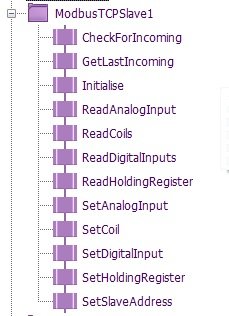

Just a heads up, I hated the way that the functions for modbus were named. We named them after official functions and really they make no sense. So now I have named them in a cleaner way so they better align with the slave device features. Hopefully making things much easier for someone coming to it for the first time.
Please beware this will break existing programs. I'm really sorry about this and can help if you need any help moving to the new version. The function parameters haven't changed just the function names.

Now everything shares the same naming convention.
So here are the registers made available on the slave.
Here are the Slave functions.
And here are the master functions.
Hopefully much cleaner than before.

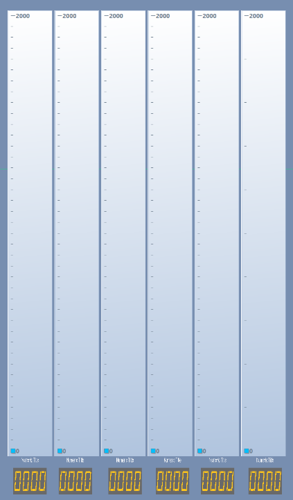

In your video there are numbers in the gauge. How did you do this? My gauge don't show numbers.

The way the scaling works on the gauges is a bit strange but this is how it works.
Minor tick step - Sets the number between each minor tick. On a ruler this might be 1 for a mark every 1mm. For your scale of 2000, 50 might be a nice number.
Major tick step - Sets the number of minor tick steps for each numeric marking. On a ruler this might be 10 for a number every 10mm. For your scale of 2000 with minor ticks of 50, 2 or 4 might be nice values.
Major 2, Minor 50 works well as does Major 5, Minor 20.
Hope this helps
Hope this helps

Perfect. It's working with the text.

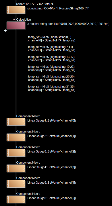

The program get a string from a bluetooth Modul with values as ascci code every 500mSec.
A small code convert the string to integer and control the gauge.
I will change the program to Modbus / Wlan soon.

// receive string look like "0015,0022,0000,0022,2010,1201,\r\n)
.temp_str = Mid$ (signalstring,0,5)
.channel[0] = StringToInt$ (.temp_str)
.temp_str = Mid$ (signalstring,7,11)
.channel[1] = StringToInt$ (.temp_str)
.temp_str = Mid$ (signalstring,13,17)
.channel[2] = StringToInt$ (.temp_str)
.temp_str = Mid$ (signalstring,19,23)
.channel[3] = StringToInt$ (.temp_str)
.temp_str = Mid$ (signalstring,25,29)
.channel[4] = StringToInt$ (.temp_str)
.temp_str = Mid$ (signalstring,31,36)
.channel[5] = StringToInt$ (.temp_str)
