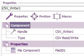

Posts: 2242
Has thanked: 616 times
Been thanked: 815 times
Re: CSV Read/Write or Output CSV
Hi Bob,
Please can you confirm the CSV Writer component has the File Component property.
If it doesn't then you may just need to update your components via the Help -> Library updates menu
RGV250
Posts: 455
Has thanked: 46 times
Been thanked: 46 times
Post by RGV250 »
Hi Ben,
I am up to date and it looks the same as above.
Bob
