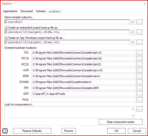

Hello everyone - LeighM -Martin
Look below at the image that shows the Options section ESP.
Is this how you think ESP should be written: ESP: C:\esp-idf \ C:\esp-idf-tools ?
Yours sincerely
Monie
Posts: 2146
Has thanked: 173 times
Been thanked: 993 times
Re: ESP toolcain!
Post by mnfisher »
Hi Monie,
No, it should just be c:\esp-idf
