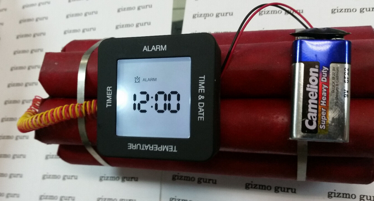

I've been beaten to it. Another dragons den moment gone
- dynamite clock.png (1.09 MiB) Viewed 4915 times

I bet the sticks don't do anything though

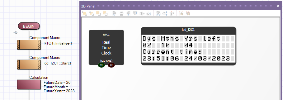

I have got a different take on this.
The attached project will work as standalone embedded, so not relying on an internet connection or it can be converted to an App Developer project so it looks like the back to the future time circuits as I did with the above link.
The way I have done it is to use an RTC and then calculate from the current date/month & year how many days months & years to the future date.
The project can be adapted to program the RTC with the current time via a keypad or by the click of a switch using curent PC time as shown with the App Developer project I linked to.

Re: Best tactic: count down clock
I'm going to study this one Medelec. Thank you!
My first idea was to use a RTC too, but in my mind, there will be a combination between a RTC and an extern source that keeps track on the remaining time as a backup.
I could use an timeserver to sync the RTC, and on certain moments use the time/date website to sync the whole lot.
I stept into the search described above. This tactic I can use in other projects too.
So receive a webpage and filter it will be the first track I want to follow.
